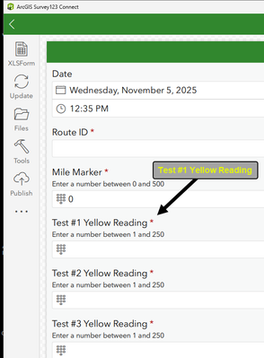

Is there a way I can control the default text color of a survey question?
Which field in the XLSForm controls that attribute?
I'm using ArcGIS Survey123 Connect, Version 3.19.116
Tags (1)
Neal_t_k
label, hint or guidance_hint

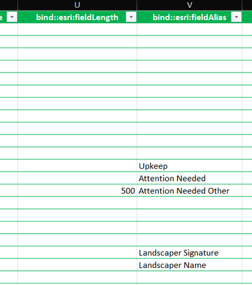

Yep you can use HTML tags in the label field like this
<font color="red">Warning  text</font>
Note this can become a pain later in the layer though as it is baked into the attribute table then.  I tend to make a separate note field for these instead.  Then set bind esri column to null and it stays out of the data.
JenniferAcunto
@DougBrowning You can use the bind::esri:fieldAlias column to set the field alias so it doesn't have the HTML baked in. I also use it when the survey question is long question and want something shorter for the actual data.
- Jen

In which column in my excel table do I paste <font color="red">Warning  text</font>?
Neal_t_k
