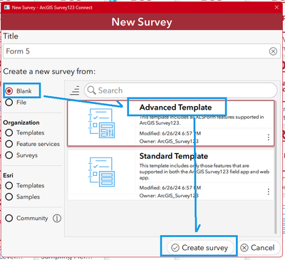

I'd suggest just 1) Create a new survey, 2) publish the survey without making changes, 3) after publishing, change one thing (maybe just add a single text box), 4) save and republish.
If that does not work, call Esri support.

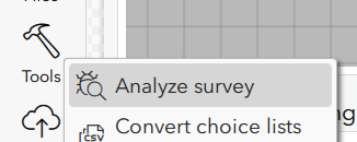

If that does works, the issue is in your XLSX. Click Tools > Analyze Survey
