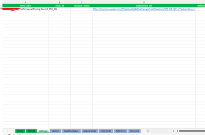

Just create a new hosted feature layer that has the field that you want to match the survey. Then Enter the new hosted feature URL in the settings sheet under the submission URL column. This will send the survey submission data directly to the new hosted feature. Just need to republish survey and it will tell you as much when you do. See attached, hope that helps.
