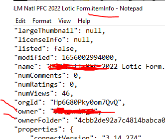

But note even if you could you still cannot have 2 people work on the same forms.  Forms are published to your AGOL owners content.
If you look in My Surveys folder at your form you will see that the owner name is baked in as is the folder id.
We had to move accounts last year and it was a big project on the 123 forms.  We had to update these two fields for every single form (250+) by hand.
Now at my last company we had a master AGOL account that we published everything from in case someone was out or left.  (I wish less was tied to users names in AGOL I gotta say).  So you could do this but you would have to say manually copy from a network location to your machine to publish.  But would not need to update the iteminfo file.  Another idea would be to have a master user and even a master VPN machine.  That way 2 diff people could login and everything would be there in the user folder.  For us no way IT would let that happen but maybe for you.
There is also a post out there that allows you to move forms to a diff user now.  But its a project and not meant to be used all the time just a one time deal.
Hope that helps.  I would love it but I get the limitations with AGOL and its not really a 123 issue.
