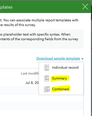

Hi @KateCarlson
go to your Survey123 website > data > report > manage template > download sample template.
Have a look and start from there, there are number of different things you can adjust.
Also, Ismael has the Answer: https://community.esri.com/t5/arcgis-survey123-blog/survey123-tricks-of-the-trade-summary-sections-i...

KateCarlson
Thank you, @PanGIS ! Ismael's tutorial is exactly what I was looking for but could not seem to Google my way there. One downside is that the summary reports cannot include maps, we can work around that for now.
Thanks again for your quick advice-
