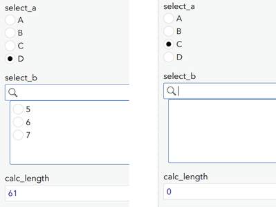

If I select an option that doesn't have any results (in your case, no Work Orders), the string-length of the JSON is 0. And if anything is returned, then the string-length is >0. Your note could be keyed to that calculation (e.g., calc_length, above).
I just made a very lazy CSV called B.csv which contained a few options and uploaded it to Portal (below). Essentially, you would just need to maintain a Feature Layer of Work Order Numbers.

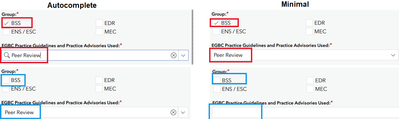

    I think the behaviour you are seeing may related to the autocomplete appearance, and I don't believe that can be changed. You could always swap to minimal appearance. Below is a Cascading Select showing that minimal clears the selection automatically:
Trippetoe
Using a Calculate as the value of the searchText worked perfectly.  I didn't have as much good look changing out the autocomplete appearance for minimal. The app behaved the same regardless of that setting. But I'm calling this a victory for now and moving on to the next hurdle.
