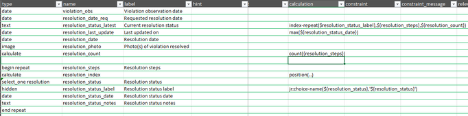

Hello,
I am trying to populate a field with the latest observation in a repeat field. I tried to follow the instructions provided here, but I am receiving an error message (see below).
Here is my XLSForm
And here is the error message
Any help would be appreciated. Thanks!

Hey @dsinha
Just a longshot, but your index-repeat, should it be indexed-repeat?
Cody
ZenMasterZeke
Try putting ${resolution_status} where you have ${resolution_status_label}

dsinha
Thanks @CodyPatterson, you are right. It is Indexed instead of Index.
Thanks @ZenMasterZeke, I changed it to ${resolution_status}.
Despite both changes, it still gives me the an error message.

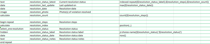

dsinha
Got it figured out. Was missing a $ sign in that count function.
Posting the final XLSForm that is working as expected
