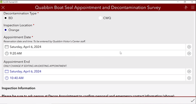

I have a Survey123 form which has been in use for about 5 years now. We use a series of calculations with date and time to schedule appointments. We are having issues with the Survey123 field app, version 3.19.120, installed on Windows desktops where any appointment made AFTER Daylight Savings Time results in an incorrect appointment end time. I have attached a copy of the XLSForm here and a Word document with some screen captures showing this example (please note this XLSForm contains a series of pulldata calculations which reference a protected hosted feature layer, so these will not work, however this will not impact testing the issue below).
Steps to reproduce this issue:
  1. Select appointment start date/time AFTER 3/10/24.
  2. Adjust appointment start time so that it starts at an interval of 20 (e.g. 0800, 0820, 0840).
  3. Click "off" to close time adjustment for appointment start time. Appointment End time adjusts but is 1 hour off (too long).
Each appointment was exactly 1 hour off (too long) in the end time.

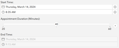

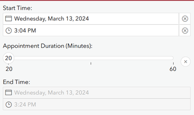

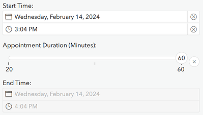

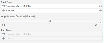

Could you please upload your XLSX?

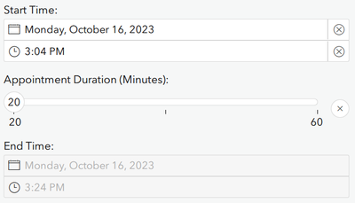

I did a quick test, and was getting the expected outcomes.
My set-up:
My tests:

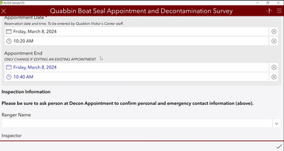

Example of issue from 3/8/24 with appointment date/time before DST - it worked fine:
Example of issue from 3/8/24 with appointment date/time after DST - notice additional hour in Appointment End:
The XLSForm syntax for the Appointment End calculation has been unchanged in my form for about 5 years, and has always worked as expected/reliably. In addition, we have always started taking appointments before DST for dates after DST without issue.

You can manually adjust for DST on PC though, which I did:
There may be something else at play. I am not aware of any strange interaction between DST and apps beyond this one system clock setting, but that doesn't mean that there aren't any.
