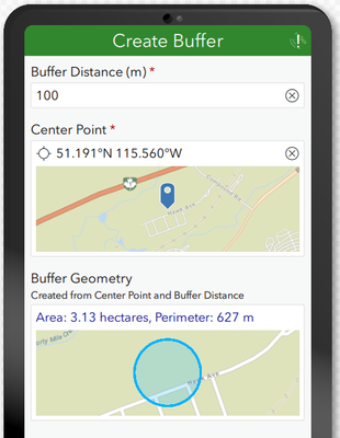

I developed some Javascript functions to create a buffer around a point/current position. This script uses the UTM coordinates from the point, calculates the UTM coordinates of 360 points around it, converts them all to Lat/Lon and creates a text string to be used in the geoshape Calculate column. You will need to save the .txt file as .js because javascript attachments are surprisingly not supported here.
Please note that this script is not perfect and can be improved. It can also be used in a Repeat to create multiple buffers around the center point.

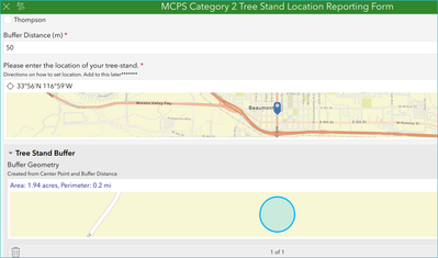

I'm having a weird issue. OB1, you're my only hope.
I'm using the form and the updated code from above, but my buffer isn't around my point in Beaumont, CA; it's in Arkansas. Have you encountered this issue before, and if so, how did you resolve it?
rrhee_bcfpd
Oops, looks like I was a bit short-sighted on my last post, and I hard-coded my UTM zone instead of leaving that as a function parameter. Likewise, I also scratched the part of the script that accounts for northern/southern hemispheres for simplicity, so that would require some modification for use in the southern hemisphere.
For the UTM zone, just replace:
  1. The function definition line "function generateBuffer..." with "function generateBufferCoordinates(zone, center_Y, center_X, buffer_dist) {"
  2. Line 49 starting with "var buff_lon = (((15 > 0...", replace the line with "var buff_lon = (((zone > 0) && (6 * zone - 183.0) || 3.0) - _a3).toFixed(7);"
  3. Then just make sure you're passing the UTM Zone parameter as the first parameter on the pulldata calc where the js call is being made
Alternatively, if you know that all of your operations are occurring in the same UTM Zone (like I did), you can simplify the script and ignore step 1 and 3 and just swap out the two "15" values in step 2 with "11" for California.
