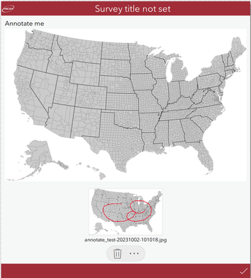

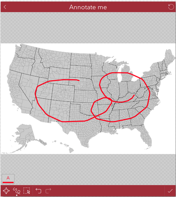

If you set the default column to an image in the media folder, when you click annotate in the survey, you will be able to annotate that image. Furthermore, if you set media::image to that same image, it will display the unaltered version of that image:

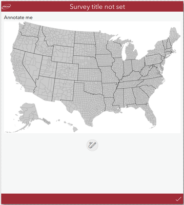

method=camera,browse,map, you can set the image's sources. Probably not something you need to set here. Fun fact though--if you specify a default image, it adds that to the list for you automatically:
previewHeight=0, shows your image at maximum resolution for the screen:

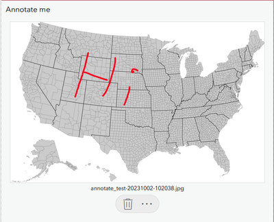

vs the default size:
