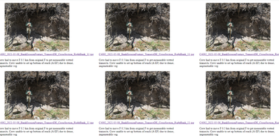

We run on field seasons so my workflow may be different but it may help.  At the end of the summer I download the service and import the records into SDE.  I run a python script that extracts the photos from the downloaded GDB using a field from the form to rename the photos to something meaningful.  The script creates a directory for each PointID on the network.  We use IIS to web enable that directory.  Then in my features I have a PhotoLink field that uses the set format http:/something.com/PointID.  We like this also for exporting to Excel.  All the photolinks come with and they all still work.
Then to get a little fancier I wrote a simple script that creates a index.html page of all the photos in that directory.  That way users do not have to click on each photo.  I then got even fancier and write any comments into the Exif info of the photo.  I use this in the HTML page so you can see the photo comments right there.
Example of screen shot (all photos are the same just as a test)
This is a little more advanced but the script was pretty easy.  With scripts I am able to extract, rename, folder, and create HTML for 8,000 photos in around 10 minutes.
This may not be for you but it works great for us.  Good luck

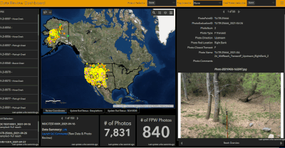

Look into Ops Dashboard also.  We made a photo review one that may work better for your use case.
AaronManuel2
Yes I think I'm going to make dashboard for our crew supervisor who is in the office most of the time. Looks good.
Is this dashboard pointing back to your web directory?
DougBrowning
MVP Esteemed Contributor
This one points to a repeat in our 123 photos form actually.
