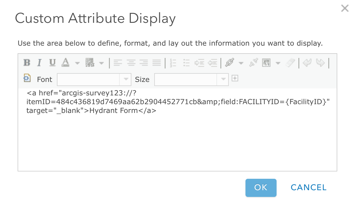

I have developed a hydrant map with popups that contain a hyperlink to a form built within Survey123.  Utilizing the recent post by Ismael ChiviteUnderstanding Survey123's custom URL Scheme I have been able to transfer each hydrant's unique id (facilityID).  Using Collector and Survey123 on my desktop the workflow works perfectly.  Yet, when I try the same process on my iPhone or iPad I only get ${facilityID} transposed into the form and not the unique id.
Please help. I have included some screen shots showing the workflow from my Mac.  The copied hydrant form URL is:
http://pasgis.maps.arcgis.com/home/item.html?id=484c436819d7469aa62b2904452771cb
Popup Configure screen Popup Hyperlink configure
Popup Screen (Title shows Survey123 screenshot from Mac showing

Ah. I see. Looking closer into your URL in the Custom Attribute  Display I noticed that  you are  separating the parameters using a semicolon instead of using an ampersand (&). Can you please try fixing that? Try something like:
<a href='arcgis-survey123://?itemID=484c436819d7469aa62b2904452771cb&field:facilityID={facilityID}'>Hydrant Form</a>

I have repeatedly inputted the following hyperlink and it automatically reverts the ampersand back to the screen shot below...
arcgis-survey123://?itemID=484c436819d7469aa62b2904452771cb &field:facilityID={facilityID}
popup config ampersand revert

The ampersand conversion &amp; is expected as part of saving pop-up - it looks the same as my working samples.  The garbled text issue is a known issue that we are working to solve.
It's a little hard to tell if there was a cut&paste formatting issue, but when you provided the arcgis-survey123 url in the comment above, there is a space between the formID and the ampersand.  I'm able to replicate the experience of having the app report the survey has not downloaded when it is already there when there is a space after the form id.
