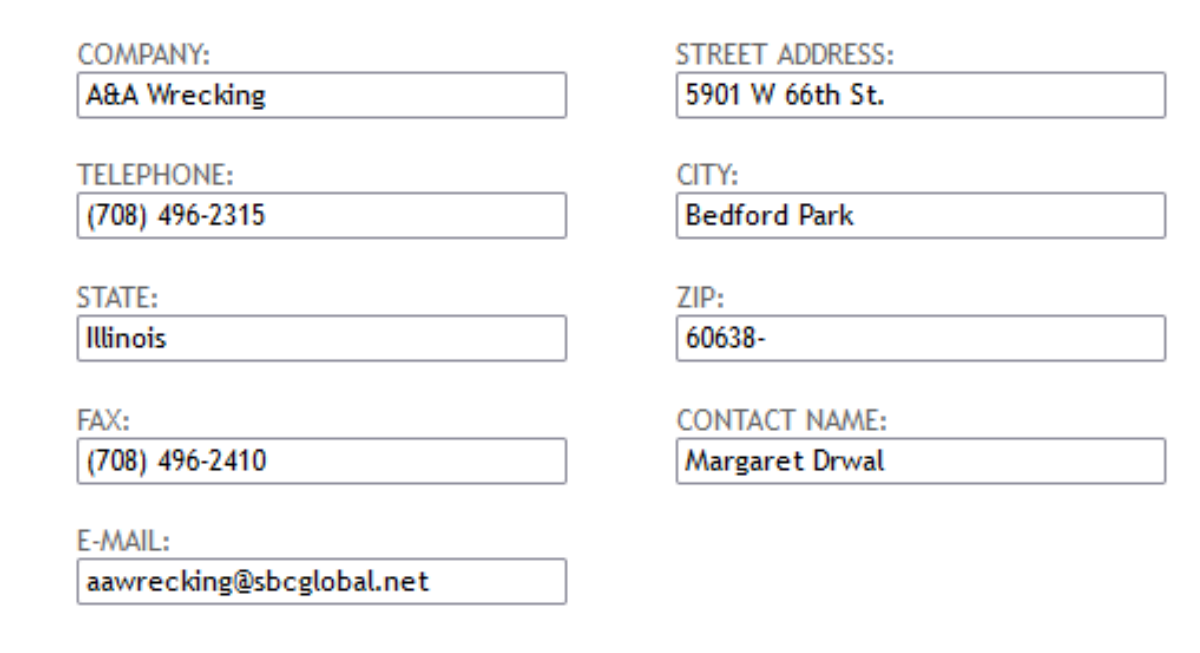

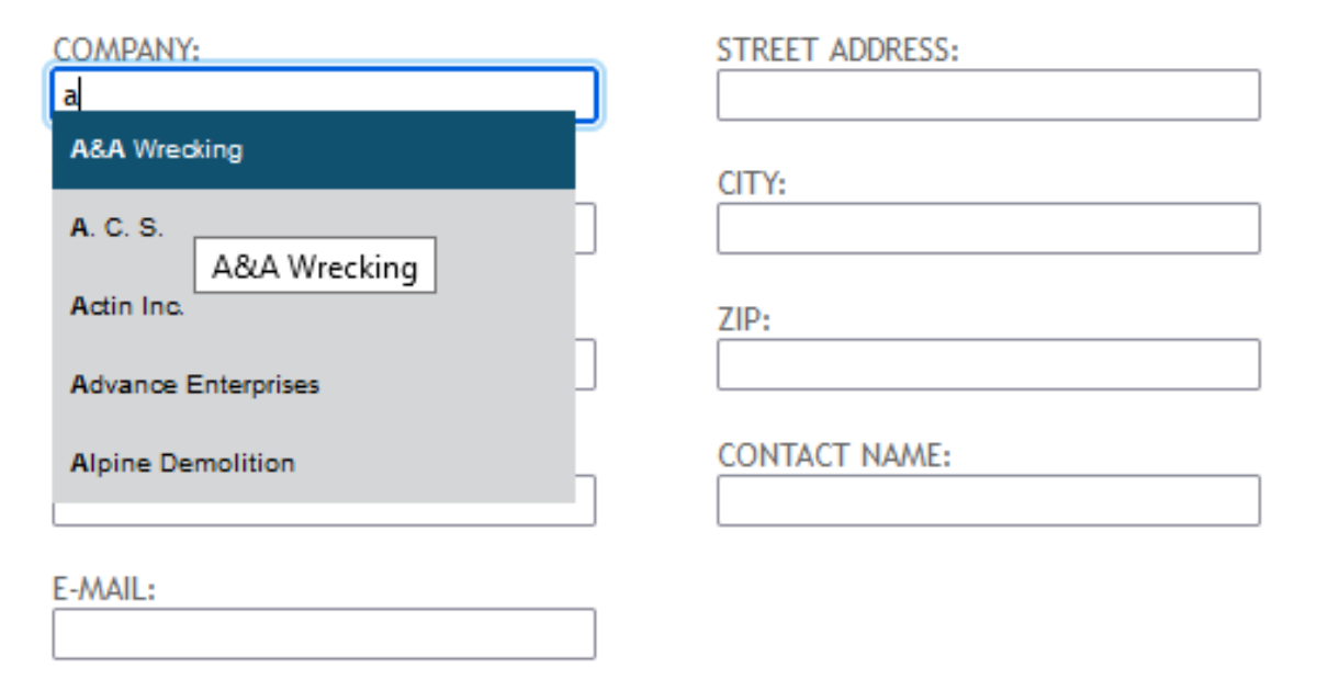

It looks like what I want to achieve can be done, maybe. I have a CSV with company names and addresses. I'm looking for a way to pre-populate the section of my survey where it asks for contact info. The end users will generally be the same companies year after year. I'm designing the survey in Connect and will ultimately publish it as a Web App (v. 3.13).
Here's an example of what I mean:
(1) The user starts typing the name of the company the begins with "a". A list of those companies show up.
(2) When the user selects a company all contact boxes are filled.

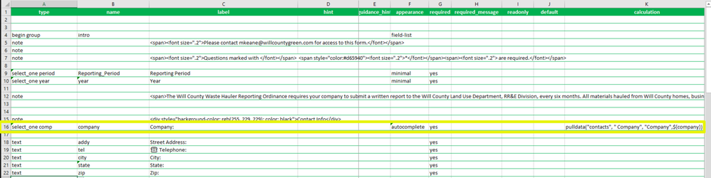

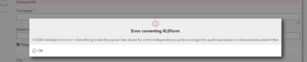

Thanks for the reply. I read fields are not supposed to refer to themselves, so I'm a little confused as to where to put the calculation. Right now I have everything in the same row (highlighted in yellow), but I get an error in Connect.
JaredPilbeam2
MVP Alum
