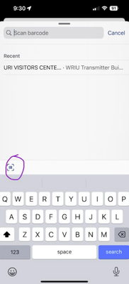

mshanaghan
Thank you for your thorough response. Those are important considerations.
My original plan was to use Field Maps for this project. Based on my research and testing, it seems like Field Maps is better than Survey 123 for editing existing data. However, my field workers are accustomed to scanning the barcode of an asset to bring up the form for that asset. They will NOT be on board with zooming and panning on a tiny screen to find one dot among thousands of others.
Until today, I thought that's what they would have to do in Field Maps. But I was wrong. It turns out that you can configure the web map in your Field Maps app to be searchable by a layer, by your barcode field specifically, and there is a barcode scanner button!
Knowing this, I will probably switch to a single feature layer edited primarily in Field Maps rather than the Survey 123 related table route.
The remaining challenge will be how to handle geometry changes. My university has implemented ArcGIS Indoors and we want to associate these data with a facility, level, and unit. Ideally, I would set up attribute rules to calculate these fields based on point in polygon calculations, but I've found the floor switching to be cumbersome in Field Maps.
