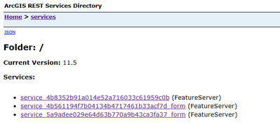

Also ensure your feature services have query capabilities.  None of the features in the link you shared have query turned on, so you won't be able to search them with their current configuration
