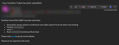

ToddW_stl
Is the ticket number being calculated in the Survey123 form, or is it an attribute rule (or both - which could cause conflicts)?  Do the survey submitters need to see the ticket number?  Ours are calculated in the database via attribute rule immediately after submission, before Power Automate sends an email (see below).  Also, if one of my answers above helped with the initial problem, please don't forget to mark as a solution to help others that may find this in the future!

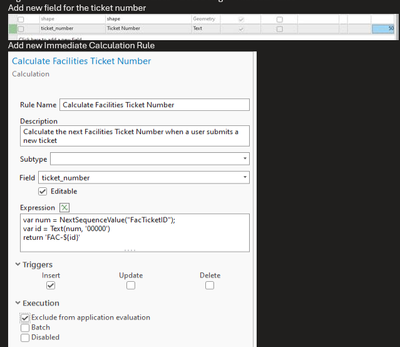

ToddW_stl
the ticket number attribute doesn't populate, or the sequential numbers aren't being added from the database sequence, or something else?  can you share a screenshot of your attribute rule settings?  unsure if it matters, but what versions of ArcGIS Pro and ArcGIS Enterprise are you working with?

ToddW_stl
here are our settings, if it helps - ArcGIS Enterprise 11.3
