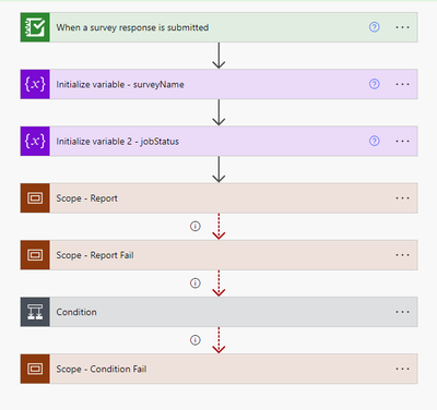

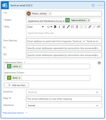

Screenshot of the overall flow:
Screenshot of the successful report email in Power Automate:
Any other screenshots helpful?

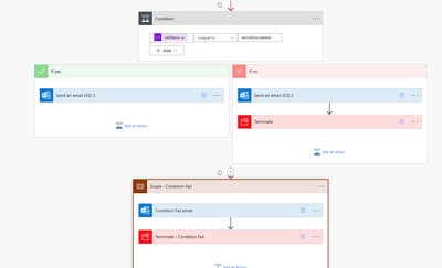

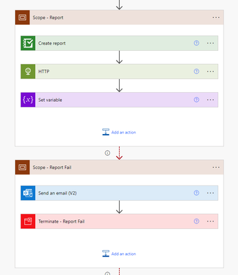

Can you expand the scopes and condition so I can see each step? From the email alone, there doesn't seem to be any reason for it to be sending more than one email. And if it did send multiple emails, they should theoretically only have the Feature Report attached.
AshleyPeters
abureaux
MVP Frequent Contributor
Hmm. Are you sure there isn't a rouge flow still turned on somewhere? Nothing there should be sending a separate email with an attachment.
Overall, your flow looks pretty good.

AshleyPeters
Knowing I can only add one array is helpful. I had run across the append to array option, but hadn't found how to make that work with images. I keep making changes to my flow, but this is how it currently stands with just the single array.
