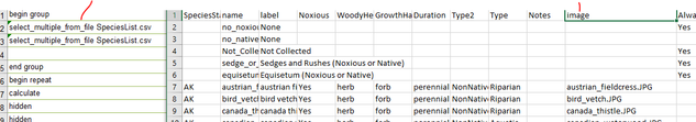

I am using select_multiple_from_file and then in my csv I have a column called image and it all works fine.
Give that a shot.  Hope I am reading your question correctly.

Well now you made my day!   Always cool to help.  Also be aware that I was remaking some of my old forms last week and I noticed that 123 calls the column media::image now in the new schema on the choices tab. image still seems to work but if you have issues try media::image.
