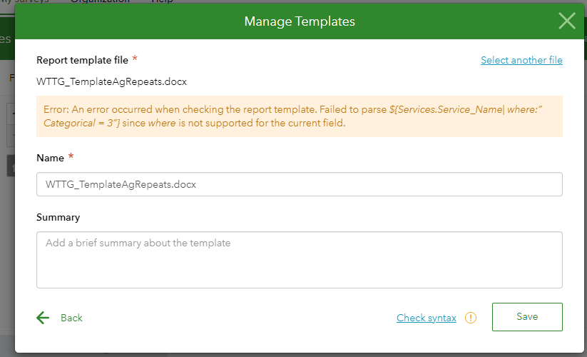

Edit: Error I receive when I try to use the where clause.

The where clause should be applies at the repeat tag ${Services} , not an individual field - the where clause sub-selects features form the repeat.
