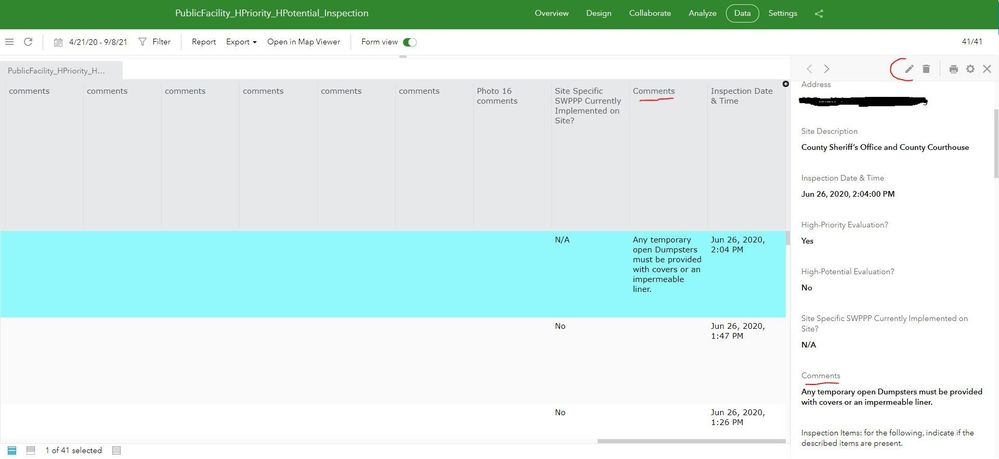

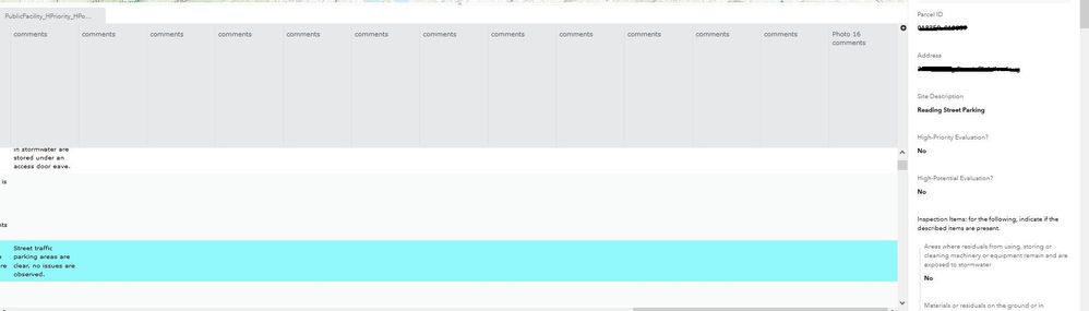

Thanks for the questions. Some additional details: inspector view.jpgsurvey owner view on data results page.JPG

  • I, the survey owner, am seem to have pretty consistent view/access to the problem field (summary comments {summary_com} which is a basic text field type). The reports I generate come out fine and include all necessary data from the entry.
  • The primary inspector reviews/edits survey results as needed on the Survey123 website in the Data tab and generates feature reports. He cannot see the summary comments field on a selected feature in the feature details on the right hand side. But if he clicks the pencil to edit the entry, the Comments field appears (and includes whatever data had been submitted). After closing the editor, the comments field goes away again.
  • 'Missing' fields are also not visible in the table for the inspector.
  • If a field is hidden for the inspector on the data tab on Survey123 website, it also comes out blank for resulting feature reports.

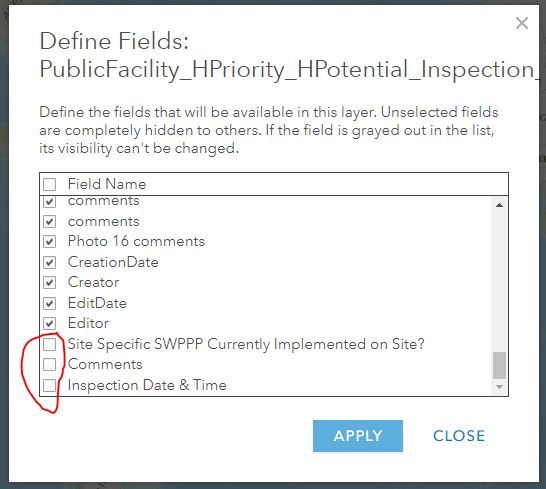

One strange this I now notice (and have no idea how it came to be this way): the feature layer's _stakeholder view on AGOL does not include the problematic fields. No clue why..... at any rate i'm updating the view definition to include those fields and am feeling rather confident this should resolve the issue.

Hi @IngridMans,
Yes I believe this is the problem. Those fields need to selected on, if you want them to be display in the Data tab, edit tab or feature reports in the Survey123 website for those that have access via the stakeholder view. If you are the owner or author of the survey, then you will always see the fields, as your login would not be using stakeholder view, and for other users, if they are fieldworker etc, it all depends on which views have which fields selected on.
