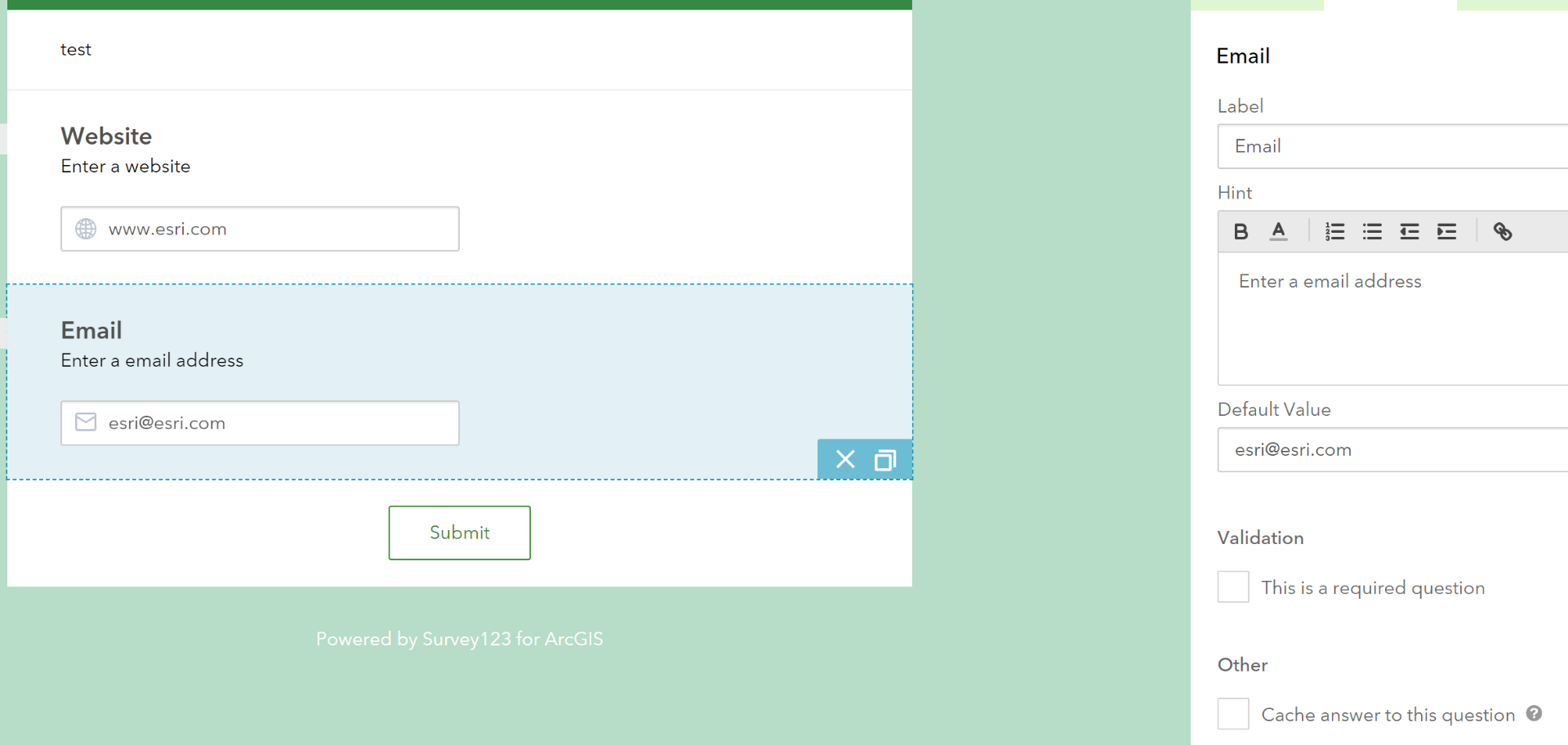

The question I had a few days ago refered to the Webiste and Email features in webdesigner. I looked and looked and could not find instructions on how to set up, use, etc. See attached .png.I pluggled in a website and and an email in design time but nothing happened, the same (editable) web and email appeared in the data collection survey.

Hi John,
The Email and Website question type on the Web Designer and for users completing the survey to enter their email or website information. Ie similar to other questions they are for collecting information. You can also set default values for each question type too, as below. The email question is not used to send email to that address, you have to use Webhooks if you want that sort of functionality. Does that help answer your question?

johnmosheim1
Phil: Ok, I see, the fields are then just like any other input box. - Thanks! John
