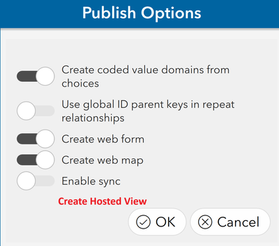

My idea is that we make this optional so organizations aren't forced into using hosted views for data collection. Perhaps it could be an option to check/uncheck when publishing the S123 form here:
