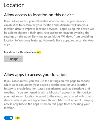

This is an older issue, but I was experiencing it myself after creating a new survey from a feature service.  I am also using a new laptop, and when I checked my location services, it was on.  However, I needed to check the button to allow apps to use the device's location for it to work in Survey123 Connect.  For those who don't know how to do this:
  1. Click the Start button and start typing "location", then select Location privacy settings
  2. Under the Allow access to location on this device section, ensure that the Location for this device is on
  3. The next section is Allow apps to access your location.  Make sure that button is lit up blue to be turned on.
