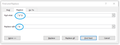

My reports have the same issue.  I love the ${if function that hides unanswered questions, but we have tons of extra lines.  I give this instruction out with our field guide document:
"The reports still need a little cleaning up.  If you do a “find and replace” you can clean up the extra lines fairly quickly.  Find ^p^p and replace with ^p."
I would like to not have to worrry about this though.

There is a solution thanks to @JamesTedrick See https://community.esri.com/t5/arcgis-survey123-questions/force-carriage-return-new-line-in-a-feature...
It worked really well to move the ${/} down to the next line with the next question, thereby putting the line break within the if statement.  I no longer need to find and replace the extra spaces.
