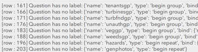

Working on a long and complex survey and have grouped several questions by theme, so that I can control relevance as a unit
I do not label these groups because I do not need them labeled; the only reason they exist is to speed up the form by reducing relevance calculations.
Every time I save them, I get a warning that they are not labeled.
Could we get the option to turn this warning off? It's blocking potentially more important warnings, and I left them unlabeled on purposed.
2 Comments
DavidSolari
This would be a handy Connect feature, but as a workaround you can make the label <span /> and it should render as blank without triggering a warning.
AlfredBaldenweck
Oh, very nice. I'll give that a shot.
