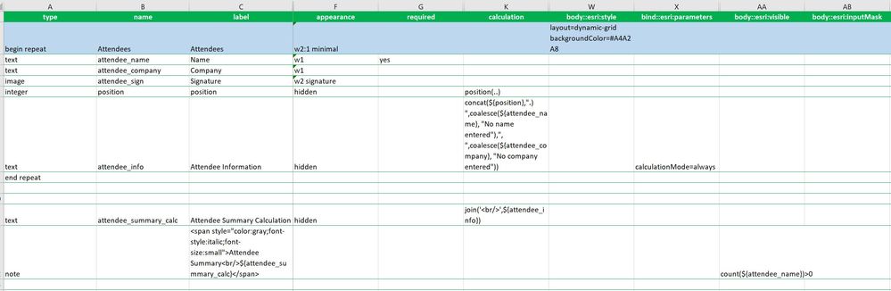

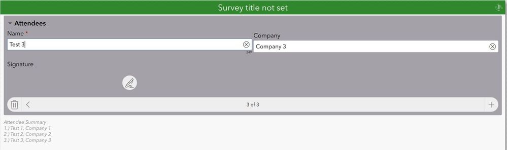

Jennifere
Still hoping this will be actioned! However, see screenshots for example of a work around for viewing previous entries in a repeat (noting this doesn't make it any easier to edit or flick between entries).

abureaux
@Strahanjen I was hoping to find a resposne from Esri in here saying something like "Yep, we're on this", and stumbled across your comment.
I use this as method to summarize data (it's almost manditory), and it works well for most use-cases. For the limitation that you described, have you tried using calculationMode=Always (place this in the bind::esri:parameters field that you want to have always update)? This should force your form to update live with any changes.
DuncanKinnear
@abureaux thanks that sounds promising, I didn't know about 'calculationMode=Always'. I shall test this out - at the moment I am just using HTML summary tables with no live links, similar to @Jennifere .
@Strahanjen - would love to know how you've formatted your summary table there with the inclusion of the cover input dropdown. I can't work out how to remove labels for those questions to achieve something similar. Cheers!
