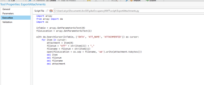

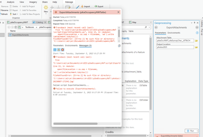

I'm having a similar traceback error using this script but I noticed this post was from last April - has the format changed with this? I see the 3 fields needed in my Attachments Table named 'images_ATTACH'. The script begins to run and exports 165 photos to my output folder before the fail occurs. I have nearly 1500 pictures in this table. Any ideas on the following error?
JamesTedrick
Esri Esteemed Contributor
Hi Adam,
This is essentially a Python 2.x issue- support for Unicode wasn't completely baked in and there are points where encoding checks need to be put in.  The main solution will be to migrate this to ArcGIS Pro/Python3.x .
AdamDaily
Thanks James,
We do have a few machines running pro so I will keep that in mind going forward as we will have to do this process a lot.
For anyone else getting this error, it is occuring within the ATT_NAME FIELD of the related pictures table. Search the jpeg names for the encoding errors like circled below. I found 3 spots in my table that needed to be fixed for this script to run all the way through:
