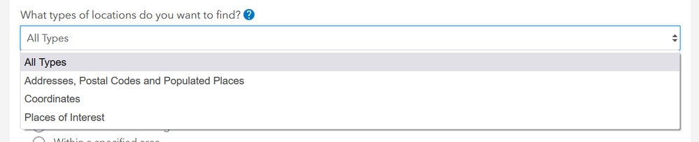

Can I use a calculation to get the closest intersection?  Calculations against a map question rely on an ArcGIS locator to perform a reverse geocode. If you want to get the closest intersection, you will need a locator specifically designed to return intersections. Checking the ArcGIS World Geocoding service, the options available are Addresses, Postal Codes, Populated Places, Coordinates and Places of Interest. There is no option to just return the closest intersection, so you will need to create your own locator with ArcGIS Enterprise, and then configure your map question to use it.
To create a custom locator, you could start with a layer containing all street intersections in your city.
