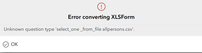

I'm having problems implementing a select_one_from_file in a survey. Despite having manually created a new row on the question type tab of my advanced template, I get this message when trying to create the survey:
The entry on my question types tab looks like this:
Can anyone tell me where I have gone astray? I am using Connect version 3.11.123. Thanks in advance for your help!
Jim-Moore
Hi @PaulMillhouser
From your screenshot of the conversion error, it looks like there might be an erroneous space in the question type?
Best,
Jim

Thanks, @Jim-Moore, but I think that is just an artifact of Excel formatting/screenshot quality. There's no space there. If there had been, I would have felt a little silly, but I also would have been relieved to find such an easy solution!

Thanks @PaulMillhouser, it was a long shot! If you're able to share your XLSForm that'd be great so I can attempt to troubleshoot. Feel free to send to me by direct message.

@PaulMillhousersorry as I am just now seeing this and I am wondering if -
Within your csv file are you using the two following columns "name" and "label" in that order?
Do you happen to have any values within these two columns that exceed 32 characters?
Is the csv file within your media folder?
Which version of the Survey123 Connect are you using to create the survey?
Here is an example that I have for one of the "question type" -
select_one_from_file EDGE_Employee_List.csv

PaulMillhouser
@MichaelBruening Thanks for the helpful thoughts. My problem turned out to be the result of their in being an extraneous space, which I did not initially see due to their being two versions of my Excel file that had gotten out of sync on my network.

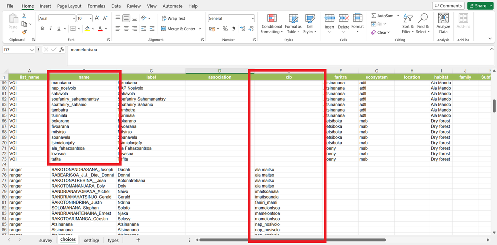

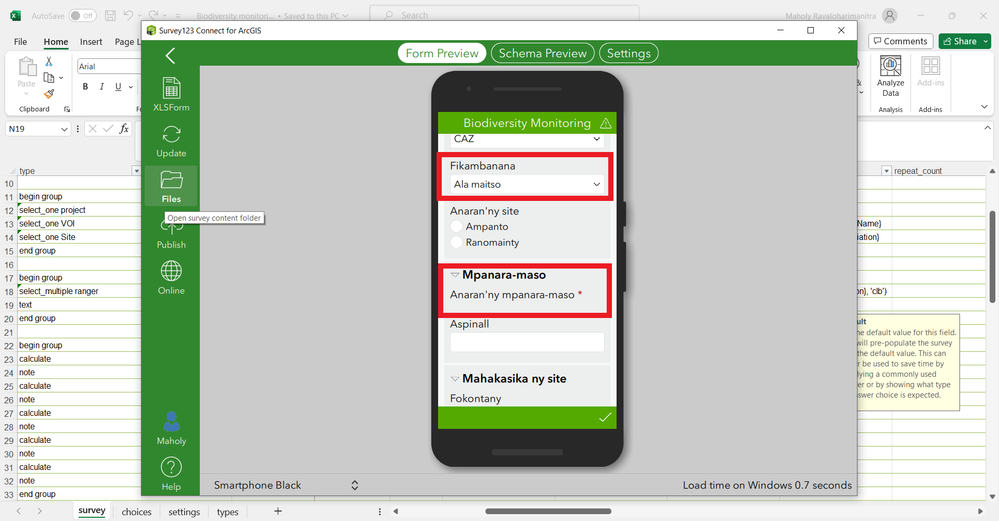

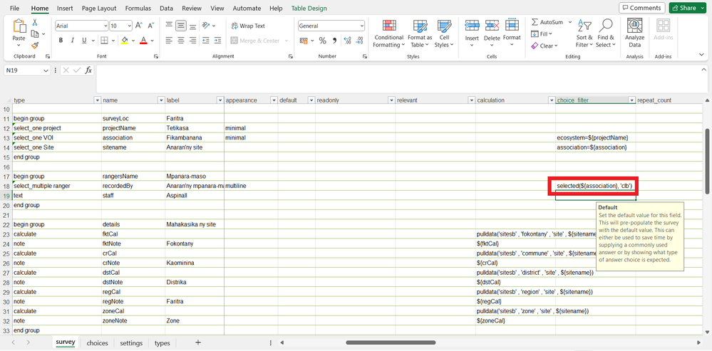

Hello,
Thank you very much for this tutorial. Very useful and helpful. However, I have one question because I have hard time trying one choice filter to work in my survey. Strangely, all the other choice filter worked, except this one. This is the situation:
I have rangers that are doing monitoring regularly, they come as a team of two to four.
They come from different associations (VOI) (cf. screenshot called "choices")
What I want to do is to only show the name of rangers related to the VOI when one VOI is selected. (cf. screenshot called "survey")
Unfortunately, I have tried all the possible formula but it didn't work (as you can see on the "preview") and you can see one of my try on the screenshot called "survey". I have tried clb=${association}, selcted(${association}, clb), selcted(${association}, "clb"), selcted(${association}, 'clb'). I am running out of idea so I would be glad to have your help
Thank youchoiceschoicespreviewpreviewsurveysurvey
DougBrowning
MVP Esteemed Contributor
I guess I am confused that the VOI name column and the clb column do not match at all?
MaholyRavaloharimanitra1
The VOI name and the clb column are matching. It was just that it was not possible to show all the line in one screenshot 😊
DougBrowning
Hmm looks like have dups in your list also?  Special chars can get you a lot.  Can you post the form.
Do you mean the excel file? 😊
