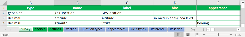

To add the compass control into a smart form, add a decimal question and set its appearance to bearing. Please note that the bearing appearance is not documented, nor is it included with the Survey123 templates. You will need to type the word bearing into the appearance column manually.

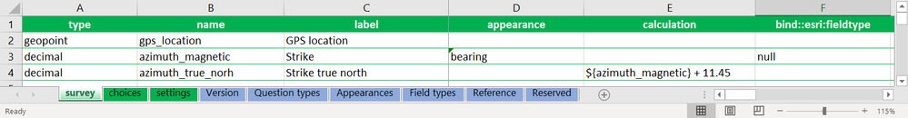

The compass control returns the azimuth measured against magnetic north. If you want the azimuth measured against true north, you need to correct the measurement using the magnetic declination at your location.
If you plan to use your survey in a reduced geographic area, you can get the magnetic declination for your area from the NOAA website and use a calculation in your form to make the adjustment.
For example, for the city of Redlands, in California, the magnetic declination is 11.45 degrees. In my XLSForm, I add a new question to apply the correction. Note that I also set the bind::esri:fieldtype column to null in the question with the bearing appearance, because I do not want to store the value without the adjustment.
