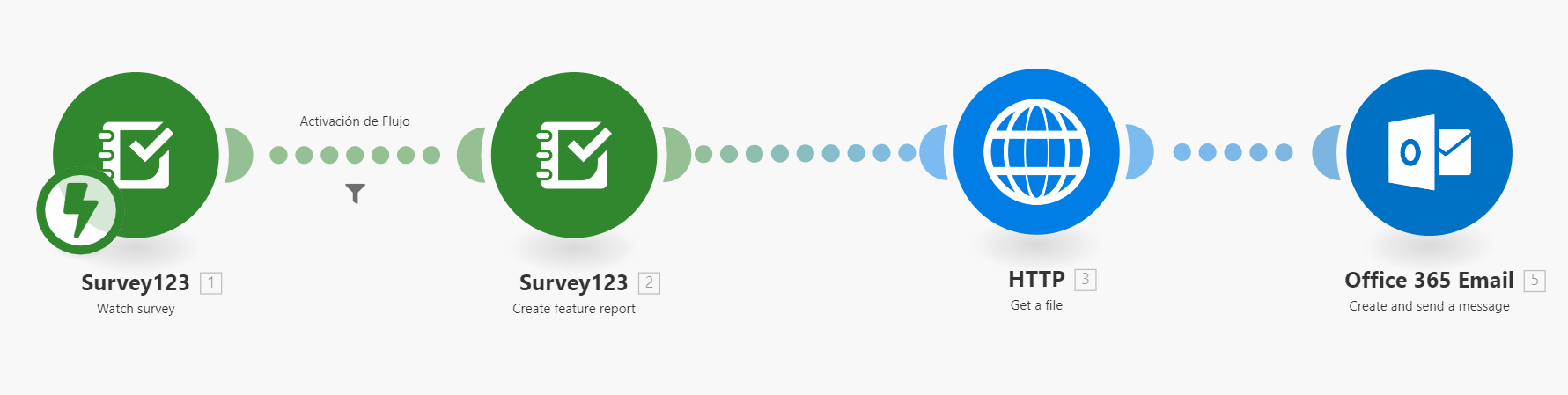

Hi James, thanks for your prompt reply.
I think I understand you, but I'm not sure how to do it. This is my scenario:
Is it necessary to add some other tool?

Hi Jeffry,
The workflow you present should be fine- the Feature Report action receives sufficient information form the Webhooks to run. If the e-mail is going to a person listed in the survey, you would want an additional HTTP request to retrieve the feature from the feature layer to ensure you have the e-mail address.
