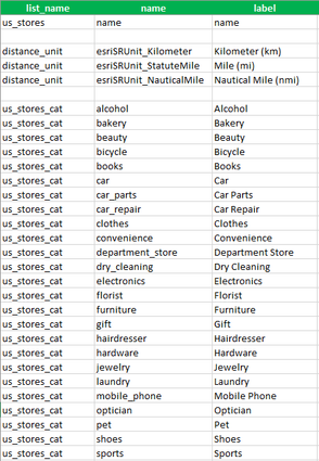

In the following screenshot a choice list called ‘us_states’ is defined on the choices worksheet and will use the field ‘STATE_NAME’ for both the choice name and label.

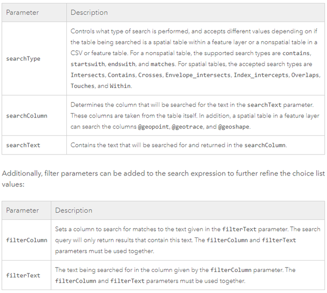

There are tables in the documentation that describe each of the optional parameters that can be used to narrow down the query results:
Let’s use these reference tables to help us understand two search expressions that utilise spatial queries (both are included in the ‘Dynamic Choice Lists using Search Appearance’ sample survey available in Survey123 Connect).

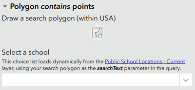

Polygon contains points
This example populates a choice list by returning values (in this case public school names, but can be any attribute value) from point features that are contained in the search polygon digitised by the survey user. It uses a geoshape question to allow users to define the search polygon and then a select_one question for users to select from the dynamic choice list.
Here is the search expression in full:
search('school?url=https://services1.arcgis.com/Ua5sjt3LWTPigjyD/arcgis/rest/services/Public_School_Location_201819/FeatureServer/0', 'contains', '@geoshape', ${search_poly})
tableName:
  • unique name school for Survey123 internal reference (could be any unique string):
  • REST endpoint URL including the layer index (0):
searchType:
  • using the spatial relationship ‘contains’, to return features in the layer that are completely contained by query geometry. Any appropriate spatial relationship could be used:
searchColumn:
  • using ‘@geoshape’ for this spatial query, as this is the query geometry type (ie polygon / geoshape):
searchText:
  • for spatial queries, this references the survey question that will provide the query geometry. Notice that parameter values don’t need inverted commas when they reference a previous survey question, ${search_poly} in this case:

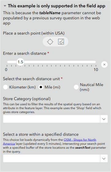

There are two examples in this group. The first example is supported in both the web and field apps as the search geometry (a 0.5 mile buffer) is hardcoded into the search expression. We will look at the second example here as this extends upon the first example to allow the survey user to define the buffer parameters on the fly (currently not supported in the web app). Both examples use all of the optional search expression parameters.
The use case for this example is a scenario where a choice list (in this case Store names) is populated dynamically based on your location and the search distance you specify. You can optionally apply a filter based on the Store category to further refine the choice list.
It uses a geopoint question to define your location, which is intersected with the buffered Store locations based on search distance (range question) and search distance unit (select_one question). Additional select_one questions provide the optional Store category filter and the final Store selection to make use of the resultant dynamic choice list.
Here the search expression is built in 2 steps.
Step 1 - creates the tableName parameter by adding the buffer parameters to the feature layer URL using the ‘concat’ function (in the calculate question named ‘search_url’). The calculation in full is:
concat("store?url=https://services6.arcgis.com/Do88DoK2xjTUCXd1/ArcGIS/rest/services/OSM_Shops_NA/FeatureServer/0&units=",${search_distance_unit},"&distance=",${search_distance})
tableName:
  • unique name store for Survey123 internal:
  • the optional query request parameters (‘units’ and ‘distance’) are appended to the REST URL of our feature layer (see documentation for feature service layers or map service layers for the full list of request parameters). These values can be hardcoded, but this example takes them from previous survey questions, namely ${search_distance} and ${search_distance_unit}.
The ‘search_distance’ question is displayed as a slider (ie a ‘range’ question type), while the ‘search_distance_unit’ question provides the options across the screen (ie a ‘select_one’ question with the ‘horizontal’ appearance).
Step 2 - adds the optional search parameters to complete the expression, here it is in full:
search(${search_url}, 'intersects', '@geopoint', ${search_point2}, 'shop', ${store_cat2})

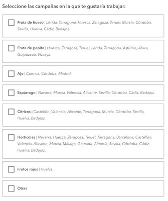

Hi!

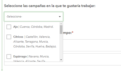

I'm ussing dynamic choice list to enhance a form with the aim for the client to be able to update the list of options for a multiple choice question.
It works correctly but the apparence in the question is of default minimal type and I would like to see all options directly.
I would like it to be like this:
I don't know if there's shomething I'm not taking into account.
Thanks for your help in advance.

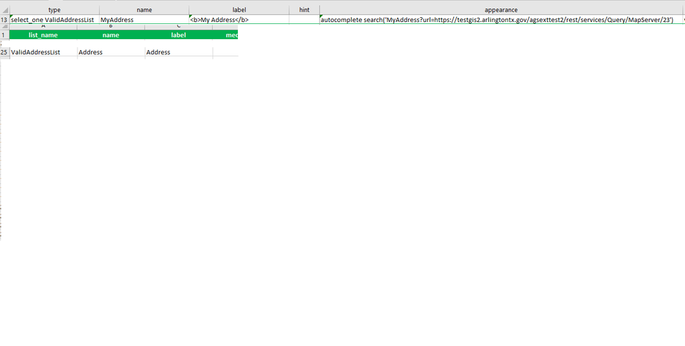

I have tried to use feature/map service published from our GIS server. It doesn't seem to work for  Survey 123 Connect. Here is what I have defined-
The excel "survey" tab - "autocomplete search('MyAddress?url=https://testgis2.arlingtontx.gov/agsexttest2/rest/services/Query/MapServer/23')"
The excel choices tab - list_name "ValidAddressList", name: "Address", lablel "Address"
What is wrong? I have tried to use another feature service published from the same GIS server for test, it still doesn't work. When I try to use the url in your blog or another ArcGIS online feature service. It works. Does the service have to be hosted in the ArcGIS online?Survey123UrlDropdown.pngSurvey123UrlDropdown.png
JavierCMartínezPrieto
good morning @HelenZhou ,
I don't know if it will help you, but the same thing happened to me, the search() function didn't recognize the name of the table (in my case) where I had to look for the value.
My solution was that I had misspelled in choice the name of the column where I had to look for the value, that is to say the name that you put in choice has to coincide with the name of the column or file where the search() function has to look for, in your case:
The excel choices tab - list_name "ValidAddressList", name: "Address", lablel "Address", list name and name has to have the same name as the location where the value is searched.
I hope this is helpful

Jesan90
Hi @BrettStokes ,
when using the search appearance, the options are loaded in alphabetical order, how do I make the options appear in a defined order.
I have tried to add the orderByField parameter "...FeatureServer/3&orderByFields=Orden DESC" but it doesn't work, I appreciate all the help given.
Notes:
  • orderByFields is true in supportsAdvancedQueries layer section.
  • I am viewing the survey on the web. On mobile if it works
Thanks,
Jeffry Jiménez

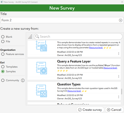

@KarenClark1 I think I figured out what you're trying to do- I also had the same or similar problem. Based on which pipeline segment a user chose, I wanted to then fill out other attributes in the survey based on their answer to that first question (which was populated using attributes from a feature layer using the "autocomplete search" function in the appearance column of the survey's excel form). In the next question, I wanted to auto-populate an answer based on the answer to the first question, so I used the "pulldata" function in the "calculation" column- the syntax looks something like this:
pulldata("@layer", "getValue", "attributes.AttributeYouWantToPull", "yourFeatureServerURL/FeatureServer/0", concat("pipelineNameAttribute = '", ${previousQuestionFieldName}, "'"))
The "Query a Feature Layer" example in the Survey123 samples was helpful for me to get the syntax down and get ideas for other ways to automatically pull in data.Screenshot 2023-04-18 090300.pngScreenshot 2023-04-18 090300.png
Hope that helps!
VaneiriPatt
Hello,
I have a database view that I published as referenced registered data. The output of this is a Feature Layer and Map Image Layer. The Feature Layer give me a Data Error but the Map Image Layer when added to a web map would show me the records.  I have tried pointing my search to the map image layer and no results is received.
@RosemaryHatch were you able to get options on your end? I see you had a map server too.
HelenZhou
@VaneiriPattHave you tried to add the map service to your AGO account and then reference the AGO item ID in you Survey 123 Connect Excel spreadsheet?
VaneiriPatt
@HelenZhou I am publishing to my ArcGIS Portal (Enterprise). I added the service to a map and had my survey use the web map url and still the options are now showing up on my survey.
HelenZhou
@VaneiriPatt I have found out Survey 123 reference url has to be either hosted in AGO/Portal or add a service (map/geocoding) to AGO/Protal and reference the item ID. Only Survey 123 app works with map service url published from a standalone ArcGIS server.
