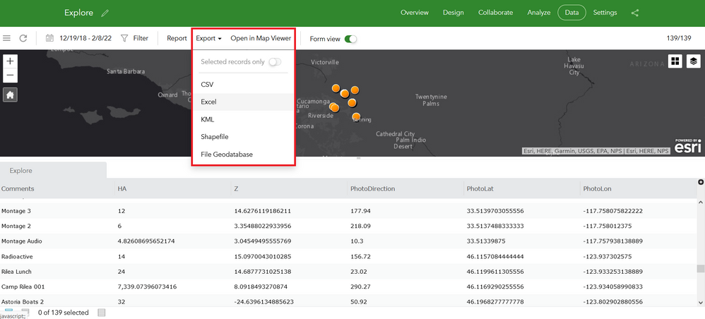

  2. In the Survey gallery, click on your Survey and go to the Data tab
  3. Scroll down, select the output format you want (CSV, Excel, Shapefile or File Geodatabase) and download your data.
