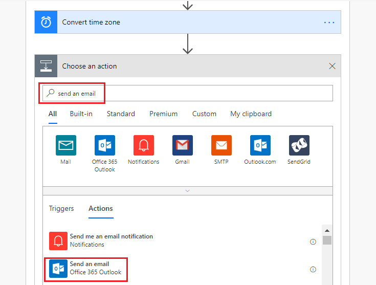

1.  Click on Add an action under 'Convert time zone' of the If yes branch of your condition.No alt text provided for this image
2.   Search for ‘send an email’ and select the action from the result list.

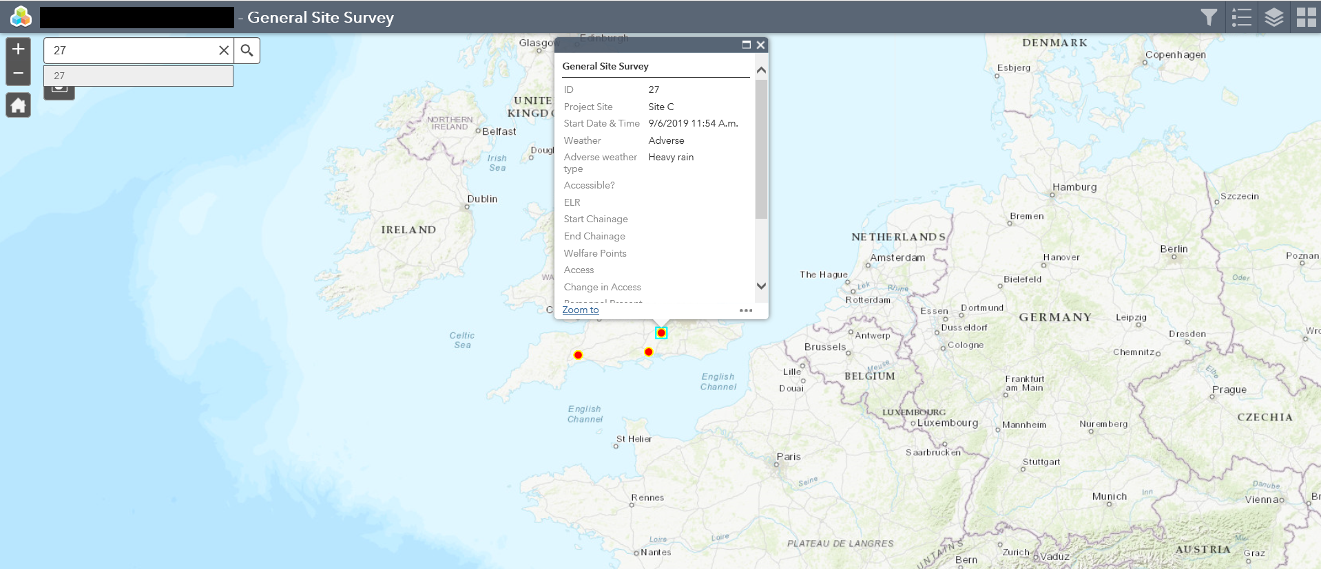

That's general formatting out of the way, so we can now focus on including dynamic content in our message template. The following example will add a hyperlink to a web map that will show the location of the reported close call when it's clicked on. We will use a web map application that is shared with the relevant AGOL group(s), thus notified people can see the reported close call in a map.
The web map application to use may contain many other layers and we only want to show the one that contains the survey data and want to zoom in onto the close call location. How do we do this? Documentation to the rescue! The online help for Web AppBuilder for ArcGIS has a section about using URL parameters - we just need to have a look at the following sections:
  • Open a saved app
  • Set layer's visibility
  • Query a feature
Using the information from the help we can construct the url:
https://<your portal url>/apps/webappviewer/index.html?id=<itemId>&showLayers=<layerID>&query=<layer...
Where to find the values required?
  • itemId: Open the item's page in AGOL and look at the end of the URL in your web browser or scroll down to URL on the item's page and copy the hash value.
  • queryField: this is the field from your layer to use for the query. (We use the OBJECTID in our example.)
  • queryValue: value coming from your survey data, so your link is dynamic and will work with any close calls. (For testing purposes you can use a static value.)
It is highly recommended to test your URL in a web browser to make sure your web map application loads with the layers you need and shows the queried feature. It would look something like this:
https://XXXXXXXX.maps.arcgis.com/apps/webappviewer/index.html?id=a0b000c00d0e0ff0gh000iiij0kkl00f&sh...
Once the URL is tested and you are happy with the results, it can go in to the email message with the rest of the dynamic content (change to 'Yes' under Is HTML first in advanced options). An example can be seen below.
The sent email would look like this:
Clicking on the hyperlink opens the web map application, pans to the feature and displays a pop-up:

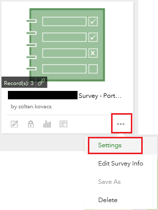

1.  Open your web browser and go to https://survey123.arcgis.com
2.  Log in and find the survey with the webhook in question
3.  Click on the ellipsis (...) button and select Settings
