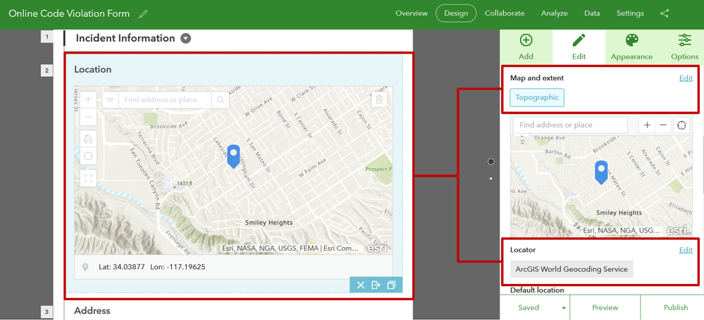

Custom maps and locators
Using web designer, you can now set a custom locator to an address or map question and choose a custom basemap for your map questions.  You can also control the maximum number of candidates returned by an address question.

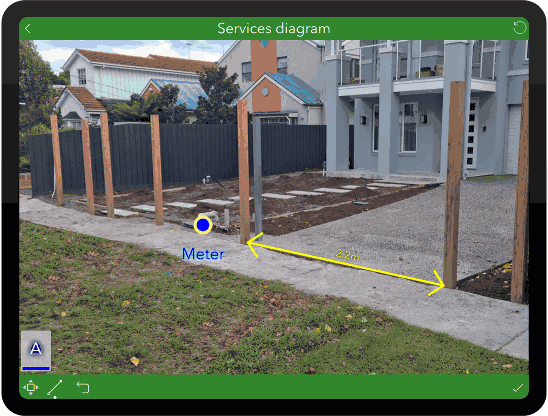

Custom annotation palettes for image annotation
In our September 2021 release we introduced major enhancements to the draw and annotate tools in the Survey123 field app. You can use these tools to annotate photos, diagrams and maps.

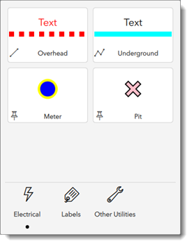

In version 3.14 beta we are introducing the concept of custom drawing tools palettes. They will help you tailor the annotation user experience to better fit the user workflow at hand. In the example below, you can see a custom palette built for a workflow involving electric infrastructure. You decide how many categories of tools you want to add, the number and their type. This is all described in detail here.

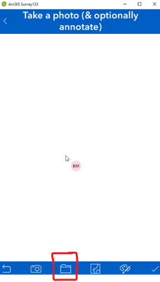

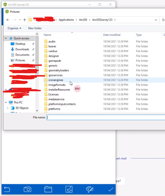

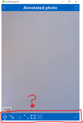

Some of our end users have just notified us they can no longer choose to browse to a photo file on the desktop version of Survey123 (3.14.237) when using the 'annotate' image type. This is a vital step to their workflow they can no longer do.
Is there anything I'm doing wrong or was this a change to the annotate image type? How would one attach an existing jpg/photo to a survey response and annotate on it?

Apologies, I just read the newest blog and saw this comment:
"Image questions (with or without the draw or annotate appearance) will not allow you to browse for existing images in your device, unless you enable local image browsing. This can be done right from within Survey123 web designer as well as from Connect using method=browse in the body::esri:style column. More details in the Survey123 Tricks of the Trade: Photos blog."
I'll test this out.
Thanks, Ben

Hello Ben,
I did some tests with yours indications : "method=camera,browse" in the body::esri:style column.
But, no good result. It's also impossible to choose photo file in the browser...
Thanks, Thibault

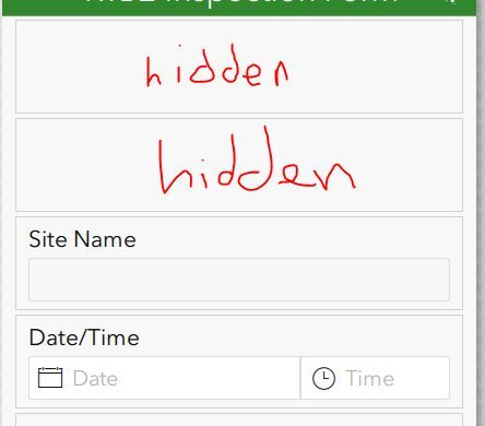

Edit: I realize "theme-grid" is not an option anymore, in favor of "dynamic-grid".
Hidden fields are showing in theme-grid, same with relevant.
