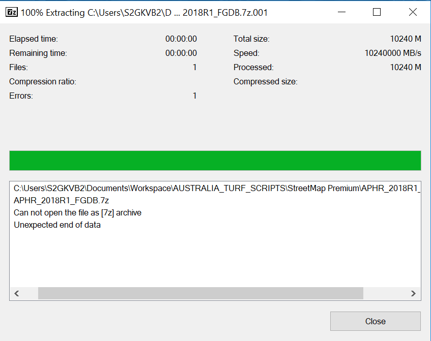

I want to use the street premium data for getting the point locations of few addresses and have successfully downloaded the data which is approx 10 GB but at the time of extracting it using 7z, I am getting error "cannot open the file as 7z archive unexpected end of data", also I have noticed that after downloading the file name is APHR_2018R1_FGDB.7z.001
How to extract the datasets from the zip file?

Need to download all the FGDB parts then only it will be extracted.
ChristopherFinn2
For anyone else searching for this question you have to highlight both parts of the files (7z.001 and 7z.002) and then extract both in the same action.
BillFox
MVP Notable Contributor
After downloading both parts, just right-clicking the first part works for me.
