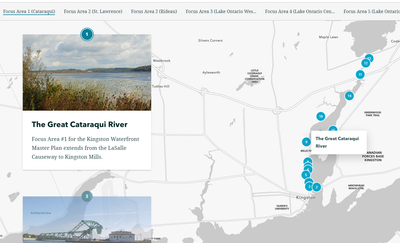

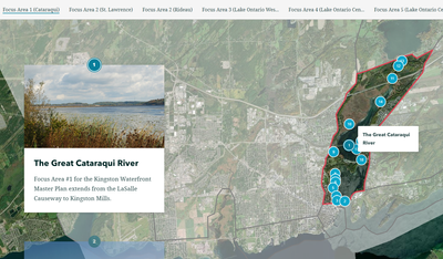

I'm having a similar issue right now. I created a storymap  that displays one of the ESRI imagery basemaps. I've made the app public and when I view it in a private window, it looks like it's displaying one of the grey basemaps instead. Is there another work around? I tried removing the "s" from "https" in the URL but when I press enter it add it back in.
What it looks like when I'm logged into my AGOL Account:
In an incognito browser:
