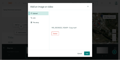

I am having issues adding MP4 video files that are well below 50MBs to my Story Map. Nothing happens after selecting and clicking on "Add" Kindly help.
See the image below.

Hello @AllanOuko
Is this issue occurring with all mp4 files, or one in particular? As a first troubleshooting step, I'd recommend attempting this upload with different mp4s in a few different browsers, like Chrome, Firefox, etc. I would also recommend reaching out to Esri Technical Support to dive into this issue further with an analyst.

Hello,
I was using Mozilla when I had issues, but I shifted to Chrome and it worked well. I have been able to add 10 MP4 videos, all between 30-49Mbs.
