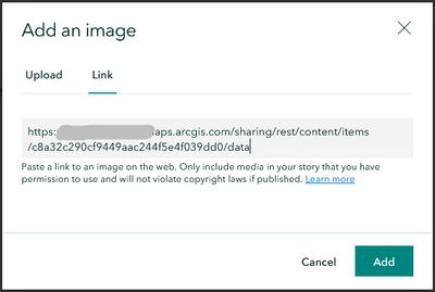

@AGP -- Make sure you are copying the link directly from the item page using the copy link button (rather than viewing it in a new tab and copying the link from the browser address bar).
The link on the item page (which should have an arcgis.com domain and end in /data) is the one you need to use in the story builder. It should look something like this:
https://www.arcgis.com/sharing/rest/content/items/982e07bc25144b0ebca77451350377c1/data
If you copy a link from the address bar it will have an AmazonAWS domain and contain an access token, which expires after a period of time. Don't use that one.

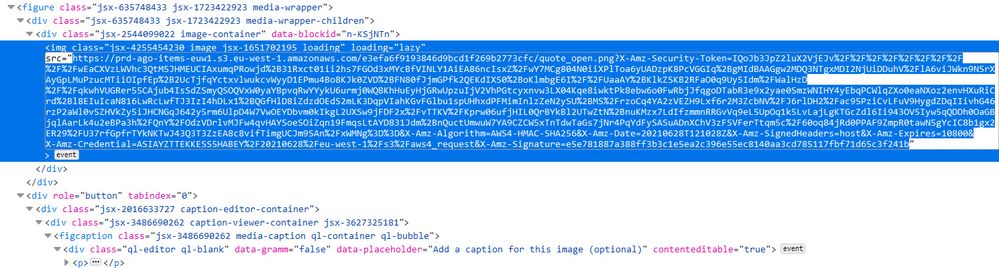

That's exactly what I've been doing all the time:
Inspecting the image element in the story I see this:
So it is replacing my ArcGIS Online link (yeah, the one with the arcgis.com domain and ending in /data) with that one with an AmazonAWS domain and a (very short lived) security token.
I remark I do not view the item in the browser and copy the link from the address bar but as you see it would be the same.
