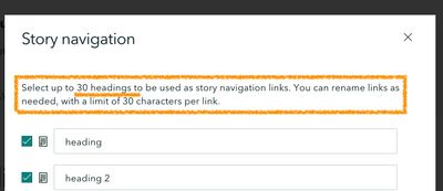

@fynboen -- Note that you need to be viewing a published story (not editing it) to see the copy link button while hovering over a heading. This is shown in the video, but that article could be clearer about indicating this detail. I'll chat with the author about getting that updated.
I'm still not sure where you saw in the app that it says you can only use 10 headings for story navigation. Below are screenshots of what I see in the Story navigation settings and in the documentation topic Add story navigation. Please be specific and provide a screenshot of the place you see a reference to there being a limit of 10 story navigation links because we'd like to correct that.

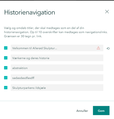

It is written in Danish, but when you click on "properties" (the gears):
this pops up:
It says: "Up to 10 headings can be added as navigation links. The limit is 30 characters per link"
Thanks for clarifying, but for some reason my headings does not make any heading links.
Does it work for you? I've published the story already:

Ah, ok -- you didn't mention you are using ArcGIS StoryMaps on ArcGIS Enterprise. 🙂 Yes, there was a limit of 10 nav links in ArcGIS Enterprise 10.8.1, but that limit was increased to 30 at version v10.9 (and was increased in the Online version in Sept 2020).
