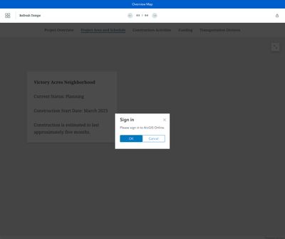

@McGehee_Melissa -- I'm getting a login screen when scrolling through the 3rd story, which means there's some content that is not shared publicly. You likely aren't seeing this the same way because you may be accessing the page when logged in. Please look into that and see if correcting the sharing level addresses the issue.

Thank you for bringing that to my attention. When I open it in incognito, I am not prompted to login in and no one else has said that they are given the login screen (that doesn't mean they weren't, I just haven't heard that). As far as I can tell, everything is shared publicly. I did try sharing a couple of other things that weren't public that I didn't think were being used, just to see if that did anything. But there is no change.
