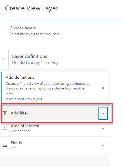

I suspect you are using the Map Tour block and selecting 'Start with a Feature Service'. You will need a filtered view of your survey layer to get your map tour to only show approved records.
Start at the Item Details page for your survey layer. Make sure you are using the Hosted Feature Layer and not one of the views that survey automatically creates.
Click Create View Layer
Go through the steps of creating a view. Ensure you add a filter to your view definition so only your approved records are visible.
Now you can return to your StoryMap and create your map tour using the view layer you just created. Note that you need to have at least one point visible in your view layer before map tour will let you pick that layer, so you may need to approve a dummy point while setting up your StoryMap. You can always go back and unapprove or delete it later and it will be removed from your StoryMap.
