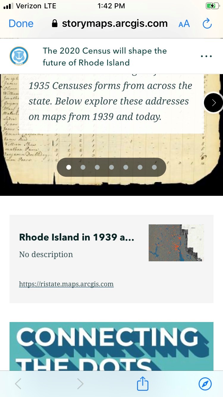

Mobile Version of StoryMap shows as "No Description" even though application has a description listed

JessicaCigna
Hello Aravind,
Thanks for letting me know. I do have a summary and a thumbnail on this and the base map that it is built from. Please advise as to why this may not be working.

AravindStoryMaps
Hi Jessica,
The information of the app's metadata is not being read in real time by stories. So would it be possible to readd the embed with the app URL into the story and seeing if the card shows the information now?
Aravind
JessicaCigna
Thank you very much. That worked!
If I can make a comment – it’s confusing for the message to be displayed as “No Description” if the descriptions pulls from the Summary field (and not Description field).
