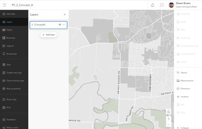

@BethanyLamb -- Hmm, I'm not seeing that KML layer when viewing your map in map viewer beta. Can you please check that again on your side?
I do see some CORS/security related errors in the console when opening your map in map viewer beta, so I do think this is an API issue, so I can try to see if our API team can have a look.
https://www.arcgis.com/apps/mapviewer/index.html?webmap=68aadb1cab1d478ea147cf518d205b60&extent=-122...

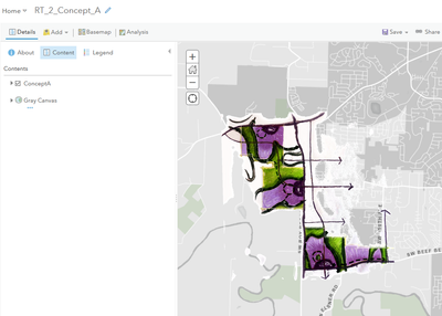

BethanyLamb
You're right. I can't actually see it in Map Viewer Beta, just the classic map viewer:

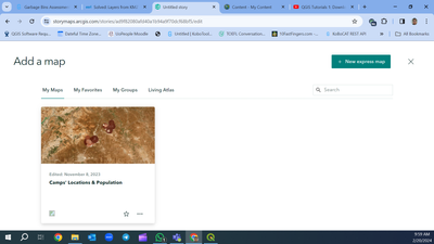

Hello,
I have this issue where I uploaded a KML file to my content in ArCGIS online and then I want to upload it to my story on GIS StroyMap but I cannot find it. I only find an old map which is web map.
Could you please help?
