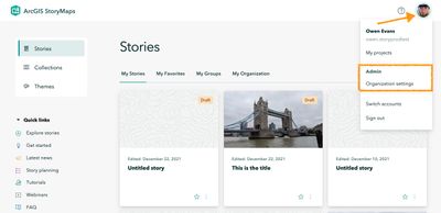

@SeanFadum1 -- Organization settings are available if you are logged in with an administrator account. They can be found in the profile menu at the top right.

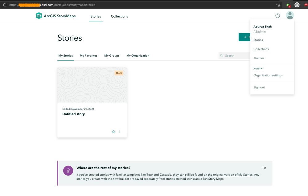

@SeanFadum1 - That screenshot was from the cloud-hosted version of ArcGIS StoryMaps on arcgis.com, but the Org settings can be found in the same place on an Enterprise portal.
The org settings are available starting at Enterprise 10.9. Here's a screenshot from a 10.9 portal.

Thanks for the response @OwenGeo   The screenshot you sent appears to be from the storymaps.arcgis.com site.
I'm looking to enable this for ArcGIS Enterprise (10.8.1).  When I look at the profile menu at the top right I only see this:
This is with an administration account.
