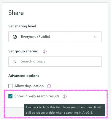

@Lvivcenter - Thanks for sharing this feedback. We have heard this from a number of customers and have been working on a way to address this concern.
Later this month, we'll be adding a capability to ArcGIS StoryMaps that will enable you to choose whether or not your published content appears in web search results. This will be a simple checkbox that you'll see when publishing a story or collection.
This option will be enabled by default; but if you uncheck this option your item will not appear in web search results. I believe this will address your request to be able to suppress the storymaps.arcgis.com URLs of your content items in web search results. 
While this setting will resolve part of your challenge, you may still have some work to do to ensure Google and other search engines see and promote your organization's URLs in search results. Our storymaps.arcgis.com URLs get ranked very high because we do a lot of work to follow SEO best practices and get high scores for accessibility and performance. You or your organization's web team will want to make sure you are doing this for your own web pages so your pages achieve high rankings.

Lvivcenter
Thank you so much! I appreciate this change - it should resolve the issue. And I think many users would benefit from that. SEO for our institutional URL is of course another task now. But it would be much easier to do. Thank you again!
