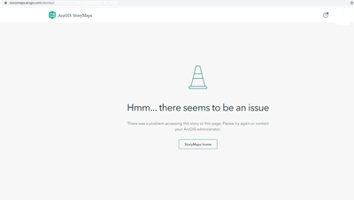

SCAGGISLA
Hi Owen,
Copying the story maps seems working however no further edits are able to make. Seems a bug.

@SCAGGISLA -- What types of accounts are you transferring between? Is either account a public account?
Owen Evans
SCAGGISLA
both accounts are organizations accounts. transferring from one AGOL org account to another AGOL account.
I tried from the source AGOL org account to ArcGIS Enterprise (10.8.1) too but almost a similar error while editing.
OwenGeo
Esri Notable Contributor
@SCAGGISLA -- As noted in the Assistant documentation, copying from Online to Enterprise (especially an older version of Enterprise) is not likely to be met with success. This is because the Enterprise codebase and data model are older than Online so there are inconsistencies.
https://guide.assistant.esri-ps.com/docs/common-workflows#anything-else-i-should-know-about-copying-...
We'll look into the AGO > AGO issue, but we haven't heard any other reports of that not working. If you can share the story publicly (from your Content page in ArcGIS Online) and provide an id we can try to take a look.
