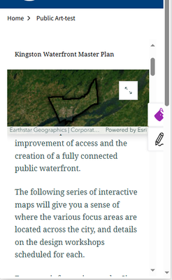

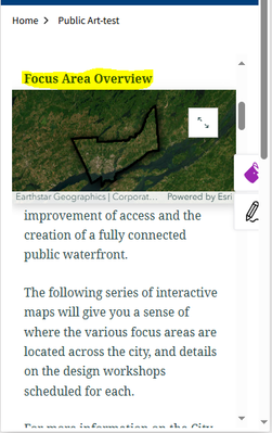

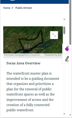

Hello, the github link doesn't seem to work for me. I've created a storymap and embedded it on a website. It looks fine on a PC but we are seeing some weird results on smaller screens. The map stays in place and the text is left in the background as the user scrolls.

SarahRijneke
Thanks for reaching out! I tweaked it at the end of last week and was able to get the title of the storymap to display in that space instead.
