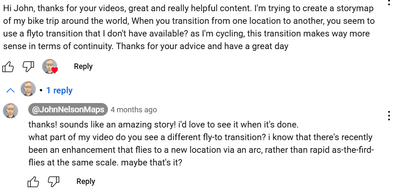

Thanks for the links.  Some of the examples in that article highlight exactly what I'm talking about ("protecting our pristine seas"). I see a comment on John Nelson's the video that highlights what I'm asking for - there's recently been an enhancement that flies to a new location via an arc. As far as I am aware, the enhancement is only available if you're using an express map. I would like this functionality to be available using a map that I already have created on ArcGIS Online i.e. a smooth pan & zoom rather than flicking right to the area of interest. If I use an express map, all of my layers are removed. I need them to be visible in the map as it pans and zooms around the map.
