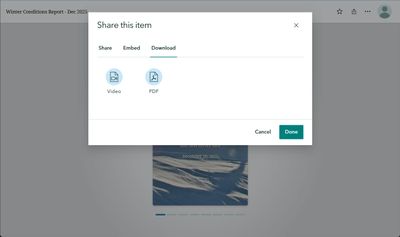

  4. After the frame has been published, open the frame viewer and click the Share button in the header to open the sharing options.
  5. In the Share this item modal, click the Download tab.
    Note: The process to create the download files can take some time depending on the number of slides in the frame. If the Download tab is not in the modal, please wait a few minutes and try again.
  6. On the Download tab, you can open and download the MP4 video and PDF files.
